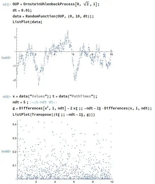

Update: In case you wonder why I insist that $\mathrm dX^2 - 2X \, \mathrm dX \neq 2 \, \mathrm dt $. You can use any program of your choice to simulate $X(t)$ and then calculate $g(t)$ as
$$ g(t) = [X^2(t + \Delta t) - X^2(t)] - 2 X(t) [X(t + \Delta t) - X(t)] $$
for small values of $\Delta t$. You will see that $g(t)$ is random. I attach below a screenshot from Mathematica that does that (I also tried writing my own program in Julia with the same result). I admit that $g(t)$ might not be the correct approximation of $\mathrm dX^2 - 2X \, \mathrm dX$, then please tell me how to do it right.
OU process in Mathematica

    In the numerical construction you get obviously $g(t)=(X(t+Δt)−X(t))^2$. The values $g(t+kΔt)$ are independent, so taking a moving average will give values that get ever closer to $2Δt$. Note that in general $ΔW_t$ is much larger than $Δt$, so that the drift term is negligible here. – Lutz Lehmann Apr 28 '23 at 12:49
  • This is indeed a correct statement, $\mathrm d X^2 - 2X , \mathrm dX = (\mathrm d X)^2$, no doubt. And I never said anything about taking an average. The question is, where the application of the Ito's lemma went wrong, why can't we just calculate $(2) - 2X (1)$ (equations are now numbered in the question)? – Yrogirg Apr 28 '23 at 14:16
