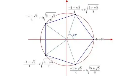

Note that
$$w^5=32e^{i2k\pi} \implies w_k= 2e^{i\frac{2k\pi}{5}}$$
with $k=0,1,2,3,4$ and for example
$$w_1 = 2\left(\cos \frac{2\pi}{5}+i \sin \frac{2\pi}{5}\right)$$

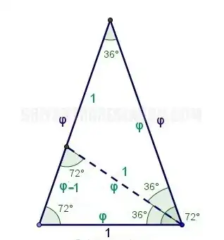

which is connected to golden ratio by the golden triangle
(image modified from credit 01, credit 02)
