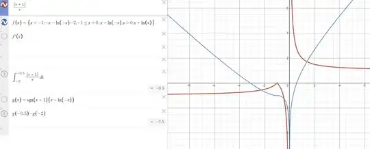

\begin{align} \int{\frac{\sqrt{x^2+2x+1}}{x}\,\mathrm dx}={}&\int\frac{|x+1|}{x}\,\mathrm dx\\ ={}&\int\operatorname{sgn}(x+1)\left(1+\frac1x\right)\,\mathrm dx\\ ={}&\begin{cases} -x-\ln(-x)-2+C_1, &x<-1;\\ x+\ln(-x)+C_1, &-1\le x<0;\\ x+\ln(x)+C_2, &x>0 \end{cases} \end{align}
  1. This integrand is disconnected at just $0,$ so its indefinite integral requires exactly two independent parameters to capture its complete set of antiderivatives.
  2. The -2 adjustment in the first case (alternatively: a +2 adjustment in the second case) is necessary! Without it, the left piece of each antiderivative (i.e., for each $(C_1,C_2)$ couple) is discontinuous, and therefore not differentiable, at $-1$ (a non-differentiable antiderivative is of course a contradiction). It is easy to neglect this adjustment and write \begin{align} \int_{-2}^{-0.5}\frac{|x+1|}{x}\,\mathrm dx ={}&\int_{-2}^{-0.5}\operatorname{sgn}(x+1)\left(1+\frac1x\right)\,\mathrm dx\\ \color{red}={}&\Big[\operatorname{sgn}(x+1)\left(x+\ln(-x)\right)\Big]_{-2}^{-0.5}\quad\quad\Large\color{red}✗\\ ={}&-2.5,\end{align} which is incorrect, because in fact $$\int_{-2}^{-0.5}\frac{|x+1|}{x}\,\mathrm dx=-0.5.$$
A visual proof:
When computing the integral on $[a,b]$ of a continuous piecewise function, using the FTC piece-wise is equivalent to determining its indefinite integral then using the FTC once (at $a$ and $b$).

    Since the red curve is continuous in $-1$ (bounded suffice though) there should exists a value of $C_1$ for which the anti-derivative in continuous in $-1$, this is not the case for your result, but $-x-\ln(-x)-C_1$ for $C_1=1$ works. – zwim Mar 11 '23 at 21:49
  • @zwim I don't understand your suggestion (the part after "but"), but I've just edited the answer to incorporate your fantastic observation (the part before "but"). Thanks so much for pointing out the subtlety! – ryang Mar 12 '23 at 11:09
  • I think the more obvious way to see that $\operatorname{sgn}(x+1)(x+\ln|x|)+C$ is incorrect is to note it gives $$\lim_{\epsilon \to 0^+} \int_{-1-\epsilon}^{-1+\epsilon} \frac{|x+1|}{x} \mathrm{d}x = -2$$ but with the integrand bounded on $x \in [-2,-1/2]$, this limit must be $0$. – aschepler Mar 12 '23 at 11:55
  • In fact $\displaystyle\sigma(x)\int f(t)dt$ is ultimately $\displaystyle\sigma(x)\int_{x_0}^x f(t)dt=\sigma(x)\Big(F(x)+C\Big)$ with $C=-F(x_0)$ and the $C$ is affected by the sign function $\sigma$. But you put it outside. – zwim Mar 12 '23 at 13:02
  • @zwim Thanks for your 2nd comment (reminding that when making the abovementioned edit, I'd neglected to bring that $\sgn$ function in Line 2 back into the indefinite integral); I've just made the correction. – ryang Mar 12 '23 at 14:20
