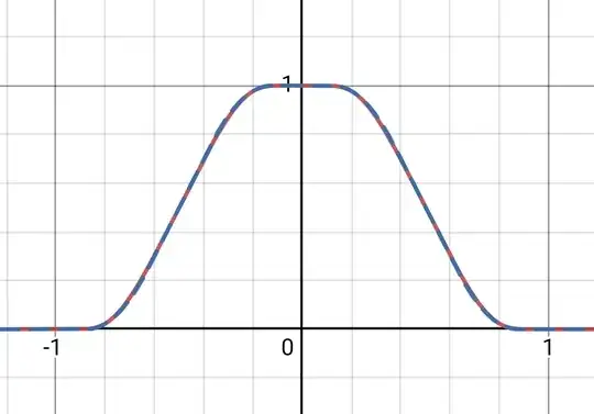

The Rvachëv function fulfills in $\mathbb{R}$ the Delayed differential equation: $$R'(x)=2R(2x+1)-2R(2x-1)$$
The Rvachëv function could be approximated in Desmos through the formula shown in this answer, or by a gross but simpler version through the function
$$f_1(x) = \begin{cases} 1,\quad x=0, \\ 0,\quad |x|\geq 0, \\ \dfrac{1}{1+\exp\left(\dfrac{1-2|x|}{x^2-|x|}\right)}, \text{otherwise}\end{cases}$$

    This is indeed a very interesting example of a smooth bump function, as it is also nowhere analytic on a whole interval (+1)! I wonder if you could make a function out of this one which truly answers my question by either extending periodically but lowering the amplitude fast enough, or by right-composing by some smooth bijection from $[-1,1]$ to $\mathbb{R}$ like $x \mapsto \tan\left(\frac{2x}{\pi}\right)$ or some other such bijection? – Bruno B Jul 16 '23 at 06:05
  • @BrunoB I don't have enough background to made some. But maybe extending the Fabius function to non-negative values as mirroring which happens with the possitive ones would work: at least all derivatives will be bounded (I believe). – Joako Jul 16 '23 at 17:49
