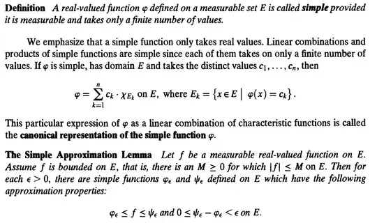

Simple approximation lemma:

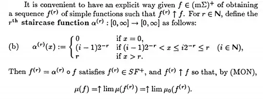

David Williams' Probability with Martingales rth staircase function:

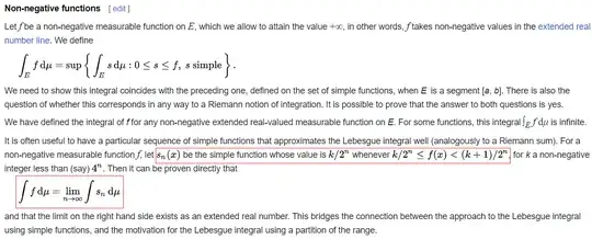

Oh wait here
https://en.wikipedia.org/wiki/Lebesgue_integration#Non-negative_functions
  1. I think it's the same as the rth staircase function in Probability with Martingales. $k=1$ to $n$ and $i=1$ to $r$.
  2. I think the Royden Fitzpatrick Real Analysis simple functions are generalisations ...with their $k$ = PWM's $i$ and their $\epsilon$ = PWM's $\frac{1}{2^r}$ sooo there are several $\epsilon$'s here...just plug in each $r$...or something.
