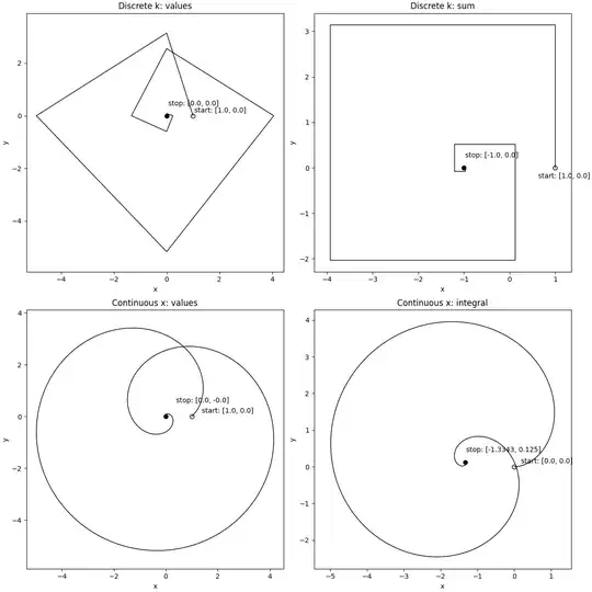

Then I took the freedom to rewrite it in a sort of continuous notation: (edit: from comment @eyeballfrog, gamma + 1. plot updated).
Pseudo Euler (continuous): $$ \int_{0}^{\infty} \frac{\pi^x}{\Gamma (x+1)} \left(\cos \left( \frac{\pi x}{2} \right) + i\sin \left(\frac{\pi x}{2}\right)\right) dx $$
$$ \int_{0}^{\infty} \frac{\pi^x}{\Gamma (x+1)} e^{\frac{i \pi x}{2}} dx =?$$
Did numerical analysis see plot below. This matched the answer given by WA (without method): $ \int_{0}^{\infty} \frac{\pi^x}{\Gamma (x+1)} e^{\frac{i \pi x}{2}} dx = -1.33432 - 0.125029 i.$

This question arises from a debate I have for some years with people who believe pi is related to the golden ratio. I debate and argue why that is not the case. The latest analysis gave this formula. As math amateur I am looking for more insight (1).

  • @ErikSatie, thank you. According you info I picture the presented plot then as cariods where radius changes as function of angle. Have to study further. – Vincent Preemen Feb 09 '23 at 15:52
