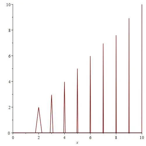

Consider
$$f_n(x)=\begin{cases}n(1-n^3|x-n|) &\mathrm{if}\,|x-n|<\frac1{n^3}\\0& \mathrm{otherwise}\end{cases}$$
That is, $f_n$ is continuous, has a triangular peak at $x$ of height $n$, and is $0$ outside of $[x-\frac{1}{n^3},x-\frac{1}{n^3}]$.
You can compute $\int_0^\infty f_n(x)\,\mathrm{d}x=\dfrac{1}{n^2}$ and $\int_0^\infty (f_n(x))^2\,\mathrm{d}x=\dfrac{2}{3n}$.
Let $f(x)=\sum_{n=2}^\infty f_n(x)$. Then $f$ is continuous on $[0,+\infty)$, $\int_0^\infty f(x)\,\mathrm{d}x$ is bounded, while $\int_0^\infty (f(x))^2\,\mathrm{d}x$ is not.
Here is a plot of $f$ on $[0,10]$: enter image description here
