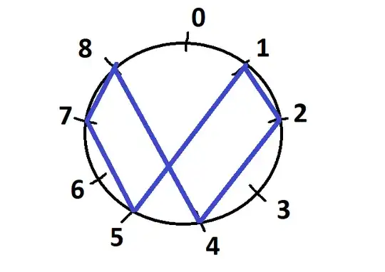

So I was aimlessly scrolling on facebook and ran into a questionable post preaching the spiritual significance of the number 9. Ignoring all the philosophy and spirituality the poster basically notices the following diagram and property and claims that this is unique to the number 9 / at the least the number 9 is a very small number with this property.
So we begin by consider the power of 2s mod 9. That is
$$ 1, 2, 4, 8, 16, 32, 64 ... \mod 9$$
which by fermat's little theorem gives the repeating sequence
$$1, 2, 4, 8, 7, 5, 1, 2, 4, 8, 7, 5 .... $$
Now if you draw this sequence onto a 9-element clock (in black below), by painting a line in order of 1,2,4,8,7,5 (in violet below) and then back to 1 you get the following image:
image of circular clock with 9 hours and with 12-o clock labelled 0 and line passing from 1 -> 2 -> 4 -> 8 -> 7 -> 5 -> 1
Unfortunately I didn't draw my clock and lines correctly to scale BUT if I had it would certainly be symmetric about the center line.
So there are a couple of interesting questions you can ask about this diagram, I'm only interested in (1) for the purposes of this post but I'll include the others if they stimulate some ideas.
  1. Which pairs if numbers $(u,v)$ have the property that $u^n \mod v$ when traced on a v-hour clock like above end up creating an image which is symmetric about the central vertical line. I was able to notice trivially that $(0,2)$ and $(1,2)$ have this property and clearly $(2,9)$ has this property so I'm tempted to ask is $(a,b)$ where $a = 0$ or $(a,b)=1$ enough to guarantee this? Are there exotic examples which don't fall into that category?

    Damn bruh this is some mathematically knowledged crackpot if they use fermats theorem to explain this – Clemens Bartholdy Jan 26 '23 at 21:30
    lmao they didn't know about fermats little theorem, but I mentioned on fb that was the underlying cause for this. I still have no good explanation for it being symmetric about the center line so that's why im here asking this. The post is from Jain108Academy on fb and the original image is from Tuzlay Art – Sidharth Ghoshal Jan 26 '23 at 21:31
    The symmetry just comes from the fact that it gets to $-1$ mod $v$ then repeats another cycle, but reflected by the $-1$ before getting back to $1$. So it has this symmetry whenever $-1$ is in the sequence. – Zoe Allen Jan 26 '23 at 21:32

  • @ZoeAllen That blows my mind a bit. This should be true any time $2$ is a primitive root... do we get threefold symmetry when $3$ is a primitive root? Have to test this... – Eric Snyder Jan 27 '23 at 02:56
