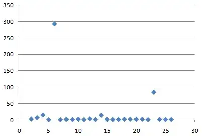

Here is a graph of $\dfrac{a_n}{a_{n-1}}$ against $n$.

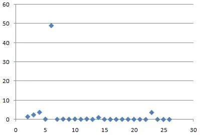

And here is a graph of $\dfrac{a_n}{na_{n-1}}$ against $n$.
Does $\dfrac{a_n}{a_{n-1}}$ have an upper bound, and if so, what is it? If not, does $\dfrac{a_n}{na_{n-1}}$ have an upper bound, and if so, what is it?
I suspect that $\dfrac{a_n}{a_{n-1}}$ has no upper bound, but $\dfrac{a_n}{na_{n-1}}$ has an upper bound of $\dfrac{a_6}{6\times a_5}=\dfrac{103993}{6\times 355}\approx48.8$. If so, then I guess the proof might be related to the (supposed) sameness of the sequence in this question with the sequence of numerators in the simple continued fraction of $\pi$.

    Little is known about the continued fraction of $\pi$. Your suggestion amounts to a rather strict bound on the irrationality measure of $\pi$, which is well beyond the current knowledge. – Ivan Neretin Jan 26 '23 at 09:30
  • @IvanNeretin Thank you. It is indeed helpful to at least know the difficulty level of my question. – Dan Jan 26 '23 at 09:36
