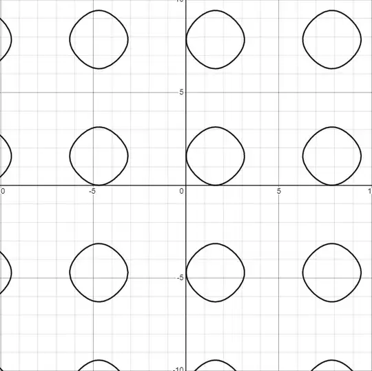

This area is exactly the same as the area enclosed by each infinitely repeating pattern in the graph $\cos (x) + \cos (y) = 1$
Graph of $\sin (x) + \sin (y) = 1$:
My working:
  • This area is exactly the same as the area enclosed by each infinitely repeating pattern in the graph $\cos (x) + \cos (y) = 1$
  • For cosine, the pattern is split symmetrically across all four quadrants of the graph around the origin so integration may be possible to find half of the desired area
  • Solve for y:
    • Subtracting $\cos (x)$ from both sides of the equation: $\cos (y) = 1 - \cos (x)$
    • Taking inverse cosine of both sides of the equation: $y = \arccos (1 - \cos (x))$
  • Since the range of the inverse cosine function is $-1 ≤ \arccos (x) ≤ 1$, if the value of $\cos (x) < 0$, the value in within the parentheses will be outside of the inverse cosine range and not be valid, so the new function has a minimum of $\arccos(1) = 0$, likewise, if the maximum y value of $\cos (x)$ would be 1, therefore the other extreme point, the maximum, of the new function would be $\arccos (0) = \frac{\pi}{2}\cdot$ Because any resulting definite integral of this function between any two valid points on the x-axis will be positive, we don't have to consider translating the graph in order to find a more appropriate area-under-the-curve value.

  • This simplifies to $0 - 0 = 0$, but it's not zero because I can see that the the area inside the pattern is a finite value, therefore half the area (the definite integral at hand) is a finite value. I don't know where I went wrong or what to do.
    It turns out that you performed the $u$-substitution incorrectly: the factor you're dividing by must go inside the integral, not outside. WolframAlpha cannot integrate $\arccos(1-\cos x)$, so maybe there is no elementary antiderivative. – Greg Martin Jan 22 '23 at 00:26
  • Maple also finds no elementary antiderivative. Numerically, $\int_{-\pi/2}^{\pi/2} \arccos(1-\cos(x)); dx \approx 3.64744119225206997400916081676$. – Robert Israel Jan 22 '23 at 06:06
  • Do you only need the definite integral or an approximation of the antiderivative ? – Claude Leibovici Jan 22 '23 at 09:10
    If I just needed an approximation I would use a ruler. –  Jan 22 '23 at 12:26
  • I'm pretty sure the definite integral has a closed-form in terms of the generalized hypergeometric function $_4F_3$. If you were hoping for a simpler final result in terms of recognizable functions, you're probably out of luck. – David H Jan 22 '23 at 12:37
Your area uses $\cos^{-1}(y)$’s series which converges on $|y|<1$ with the Pochhammer symbol $(u)_v$:
$$\int_{-\frac\pi2}^\frac\pi2\cos^{-1}(1-\cos(x))dx=2\int_0^\frac\pi2\cos^{-1}\left(2\sin^2\left(\frac x2\right)\right)dx=2\int_0^\frac\pi2\frac\pi2-\sum_{n=0}^\infty\frac{\left(2\sin^2\left(\frac x2\right)\right)^{2n+1}\left(\frac12\right)_n}{(2n+1)n!}dx$$
Switching operators gives:
$$\frac{\pi^2}2-\sum_{n=0}^\infty\frac{2^{2n+2}\left(\frac12\right)_n}{(2n+1)n!}\int_0^\frac\pi2 \sin^{4n+2}\left(\frac x2\right)dx= \frac{\pi^2}2-\sum_{n=0}^\infty\frac{2^{2n+1}\left(\frac12\right)_n}{(2n+1)n!}\int_0^\frac\pi4 \sin^{4n+2}(x)dx $$
Next, use the $\int \sin^r(x)$ to incomplete beta B$_x(a,b)$ identity.
$$\int_{-\frac\pi2}^\frac\pi2\cos^{-1}(1-\cos(x))dx=\frac{\pi^2}2-\sum_{n=0}^\infty\frac{\left(\frac12\right)_k4^{n+1}}{(2n+1)n!}\text B_\frac12\left(\frac32+2n,\frac12\right)$$
Finally, use a B$_x(a,b)$ series, switch the series, and simplify with hypergeometric $_4\text F_3$:
$$\boxed{\int_{-\frac\pi2}^\frac\pi2\cos^{-1}(1-\cos(x))dx=\frac1{\sqrt\pi}\left(4\Gamma^2\left(\frac34\right)\,_4\text F_3\left(\frac14,\frac14,\frac34,\frac34;\frac12,\frac54,\frac54;\frac14\right)+\frac{\Gamma^2\left(\frac14\right)}{36}\,_4\text F_3\left(\frac34,\frac34,\frac54,\frac54;\frac32,\frac74,\frac74;\frac14\right)\right)= 3.64744119225206997400916081676416139843462\dots}$$

We can make a decent approximation of the antiderivative using one of my favored $\large 1,400$ years old approximations $$\cos(x) \simeq\frac{\pi ^2-4x^2}{\pi ^2+x^2}\qquad \text{for} \qquad -\frac \pi 2 \leq x\leq\frac \pi 2$$
This gives $$I_1=\int \cos ^{-1}(1-\cos (x))\,dx \sim \int \cos ^{-1}\left(\frac{5 x^2}{x^2+\pi ^2}\right)\,dx=I_2$$ To check, consider the norm $$\Phi=\int_{-\frac \pi 2}^{+\frac \pi 2}\Bigg[\cos ^{-1}(1-\cos (x))-\cos ^{-1}\left(\frac{5 x^2}{x^2+\pi ^2}\right) \Bigg]^2\,dx=6.145\times 10^{-6}$$
$$I_2=x \cos ^{-1}\left(\frac{5 x^2}{x^2+\pi ^2}\right)-5 i \sqrt{\frac{2}{3}} \pi \,\large A $$ where $${ \large A}= F\left(i \sinh ^{-1}\left(\frac{\sqrt{6} }{\pi }x\right)|-\frac{2}{3}\right)-\Pi \left(\frac{1}{6};i \sinh ^{-1}\left(\frac{\sqrt{6} }{\pi }x\right)|-\frac{2}{3}\right)$$ Some results for the integration between $0$ and $t$ $$\left( \begin{array}{ccc} t &\text{approximation} & \text{exact} \\ 0.1 & 0.1569109 & 0.1569131 \\ 0.2 & 0.3128116 & 0.3128286 \\ 0.3 & 0.4667036 & 0.4667585 \\ 0.4 & 0.6176100 & 0.6177321 \\ 0.5 & 0.7645818 & 0.7648015 \\ 0.6 & 0.9066998 & 0.9070419 \\ 0.7 & 1.0430706 & 1.0435487 \\ 0.8 & 1.1728158 & 1.1734269 \\ 0.9 & 1.2950534 & 1.2957741 \\ 1.0 & 1.4088677 & 1.4096524 \\ 1.1 & 1.5132609 & 1.5140428 \\ 1.2 & 1.6070722 & 1.6077677 \\ 1.3 & 1.6888294 & 1.6893476 \\ 1.4 & 1.7563969 & 1.7566577 \\ 1.5 & 1.8059298 & 1.8058995 \\ \end{array} \right)$$
