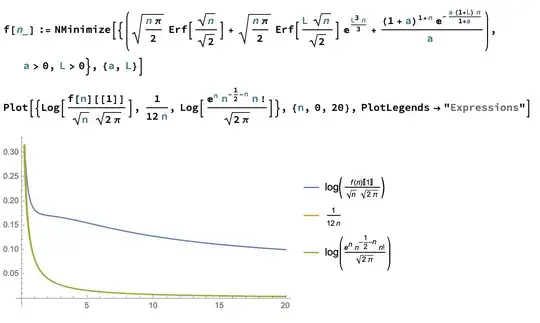

I tried to redo the computations with as few approximations as possible, and then optimize the constants numerically.
In particular, I took the $e^{-n x^2/2}$ integral from $-1$ to $1$, the $e^{-n x^2/2 + n L^3/3}$ from $0$ to $L$, and I generalized the linear bound in the tail to use an arbitrary constant, $a$.
I then plotted the error, $r_n$, when $n!\approx (n/e)^n \sqrt{2\pi n} e^{r_n}$:
graph
It seems like, while I'm definitely getting $r_n=o(1)$, even tuning every parameter as much as I can, there's no way to get to $r_n\sim 1/(12n)$, at least for small $n$.
I wrote this update as an answer, since that's what it may be: "There's no way to get Robbin's inequality with Laplace's method."
However, I'm definitely very interested in being told otherwise.
