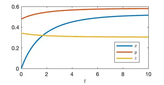

Figure 1: Solution as a function of $t$ (for $a=0.1$). Solution in terms of <span class=$t$" />

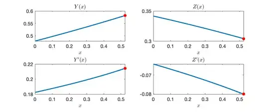

Figure 2: Solution represented by functions $Y,Z$ such that $(x_t,y_t,z_t)= (x_t,Y(x_t),Z(x_t))$ for all $t\geq 0$ (the red point represents the critical point of the system):
Solutions in terms of the functions <span class=$Y$ and $Z$." />
