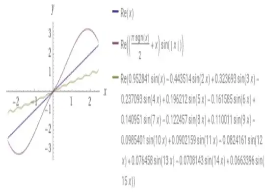

After transforming $x\cos(x)$ into $\left(\frac\pi2\text{sgn}(x)+x\right)\sin|x|$ , there is an explicit solution using Fourier sine series of an inverse function. Note the scaling was adjusted for a more accurate graph:
setting $x=-1$ gives:
$$\boxed{\sec(a)=a\implies a=-\frac\pi2-\frac1\pi\sum_{n=1}^\infty \sin(n)\int_0^\frac\pi2 t\sin\left(n\left(t+\frac\pi2\right)\sin(t)\right)(2t\cos(t)+\pi\cos(t)+2\sin(t))dt=-2.073932809\dots}$$
Which converges slowly here. A basic attempt at the coefficients expands $\sin(y)$ as a series and the inner $\sin(t)$ with exponential functions. Then we used the binomial theorem:
$$\int_0^\frac\pi2 t\sin\left(n\left(t+\frac\pi2\right)\sin(t)\right)(2t\cos(t)+\pi\cos(t)+2\sin(t))dt=\sum_{k=0}^\infty\sum_{m=0}^{2k+1\text{ or }\infty}\frac{(-1)^k}{m!(2k-m+1)!}\left(\frac{in}2\right)^{2k+1} \int_0^\frac\pi2 t((2t+\pi)\cos(t)+2\sin(t))\left(t+\frac\pi2\right)^{2k+1}e^{i((2(m-k)-1)t-m\pi} dt $$
The indefinite integral is a sum of four incomplete gamma functions which are too long to write out as a final answer. Hopefully, there is a simpler expansion. Similar methods will probably find more fixed points.
