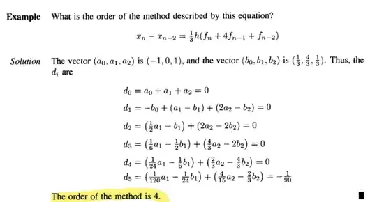

Edit I am editing the question to make it more general. It is not specific to any ODE method.I found one solved example in the book where is calculates the order of multistep method. Reading through, it gives a hint that order of local truncation error is one more than order of method. enter image description here My question is this can this rule be applied to all multistep ODE methods to find order and the order of local truncation error is 1 more than order of method? Thank you for great help.
Book - Numerical Analysis: Mathematics of Scientific Computing By Kincaid and Cheney, 3rd edition

  • Thank you for your response @LutzLehmann. I edited the question a little. Somehow I think I found a general method to calculate order. Earlier I though order of method is found from the local truncation error. But I think I was wrong. For finding order of method, we only need the ODE method equation. Please review. – Manu Dec 10 '22 at 00:25
  • Yes, for multi-step method the order as quadrature method gives the order of the integration method. For Runge-Kutta methods the quadrature method, solving $y'(x)=f(x)$, can be higher than the order as ODE integration method, solving $y'(x)=f(x,y(x))$. – Lutz Lehmann Dec 10 '22 at 06:47
