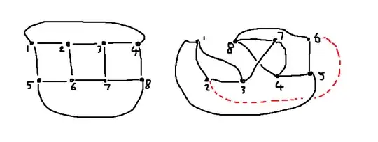

For example, even if we know the $3$-cube has eight $0$-cells, twelve $1$-cells we can't just link the eight vertices willy-nilly. I will draw a correct diagram of the $1$-skeleton on the left, and an incorrect one on the right: Diagram
The purpose of these diagrams is to show that, without prior visual knowledge, it's quite easy to write down an incorrect cellulation. I could easily write down similar diagrams for purported $1$-skeleta of a $4$-cube, but I'd have no way of knowing if they were right. I could probably compute the homology or something similar to show incorrect diagrams are incorrect, but this is circular w.r.t my purposes and also doesn't tell me how to do it correctly - by 'no way', I mean that I personally do not know a way. There must be some way, and this is the essence of my question!
To impose some sanity, I've ensured every vertex has three edges coming out of it, since I "know" this should be a rule. How can I possibly know this for sure? It is 'obvious' that the $n$-cube cellulated in this way must have $n$ $1$-cells attached to every $0$-cell, but I wouldn't know how to prove that. Moreover, I need more than this: I need systematic rules for how many $2$-cells should be associated to every $1$-cell, I need rules for attaching $1$-cells such that attaching the correct $2$-cells is even possible... and I need rules telling me that this cellulation will, in the $n$th stage, produce (a homeomorph of) the $n$-cube. I haven't tried to visualise my "incorrect" diagram, but I'm almost certain it is not identifiable with the $1$-skeleton of the $3$-cube. At least, I'm certain I could attach $2$-cells to it in a 'random' way so as to make something that is not equal to the $3$-cube.

When dealing with CW complexes, it is useful to know that the product of a $k$-cell and an $n$-cell is a $(k+n)$-cell. (See Cartesian product of two CW-complexes, for example.) So if you want to find a CW decomposition of $(S^1)^n$, one option is to use the two-cell description of a circle (one $0$-cell and one $1$-cell) and take its $n$-fold product with itself. If we describe the cells of the circle as $e^0$ and $e^1$, and if we further label the cells of the $i$th circle in the product as $e^0_i$ and $e^1_i$, then the typical cell in $(S^1)^n$ will look like $e_0^{i_0} \times \dots \times e_n^{i_n}$ where each $i_j$ is either 0 or 1. The dimension of this cell is $\sum i_j$, so you will get $\binom{n}{k}$ $k$-cells, one for each choice of $k$ indices $i_j$ which will value $1$.
Furthermore, you get a description of the attaching maps for the cells (same link), and in particular, the boundary of each cell in this particular description will be zero: the cellular chain complex will have trivial boundary maps, so the homology will be the same as the chain complex.
The same sort of argument will work for an $n$-cube, using its description as an $n$-fold product of the unit interval with itself, but the boundary maps will be nonzero and the computations will be harder. Fortunately an $n$-cube is contractible, so you can get the homology groups from that.
