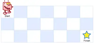

There is a LeetCode question called Unique Paths that asks the number of ways that one can reach the lower-right corner of a $m \times n$ grid if you start in the upper-left corner and want to reach the lower-right corner, only being able to move down or right at any step.
Visualization of the $3 \times 7$ case, for example:
LeetCode unique paths 3x7 example
