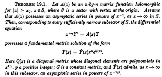

Question: I'm looking for a reference which shows that Prop. 1 is true, or true provided with some other technical condition. It seems similar to Theorem 19.1 of Asymptotic Expansions for Ordinary Differential Equations by Wasow but I don't fully see the connection.
