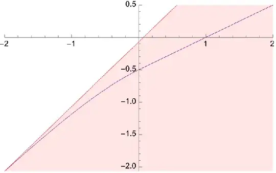

The following animation is similar to the one on wikipedia but for your specific function and Lipschitz constant $\alpha=1$. You can see that $T$ is $1$-Lipschitz because its graph stays inside the shaded area.
Graph of 1-Lipschitz function stays inside a cone
For any $\alpha$ strictly smaller than $1$ the graph will always leave the shaded area at some point $x_0$ "if you sail far enough to the west" as Tolkien would say. You can see this in the following animation for $\alpha=0.99$ on the interval $(-700,-690)$.
Graph of function leaves cone
