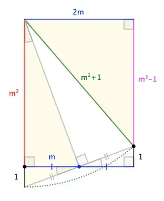

    @F.Conrad Is it possible to derive this formula from $(a+b)^2$, an old proof consisting of 4 right triangles inside a big square? – YGranja Sep 15 '22 at 11:28
  • That is actually a good idea. You got can get rectangles with (I donote $area=a\cdot b$, one side times the other) respective sizes $2m \cdot 2m$, $m^2 \cdot m^2$ and so on, one corresponding to each term in the equation. Then you can possible rerrange them in a nice way. The minus sign on the left side corresponds to splitting the rectangle $2m \cdot 2m$ in half. – F. Conrad Sep 15 '22 at 11:52

Here's a visual proof:
(This space intentionally left blank.)
Blue
