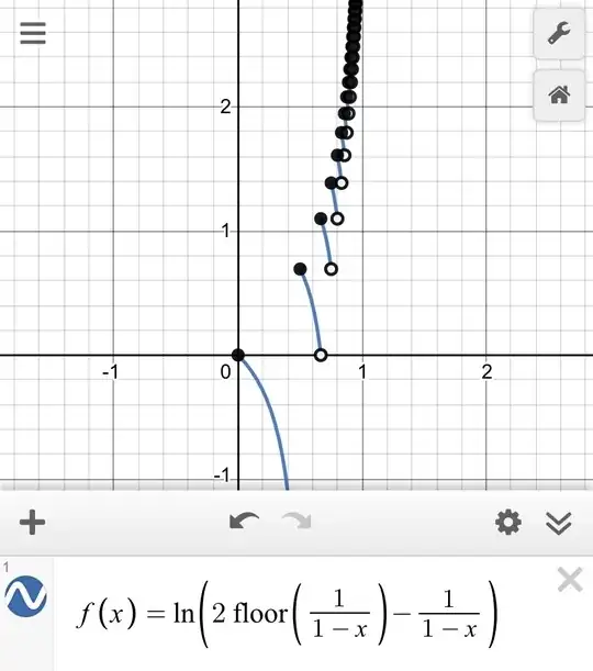

Here is one example. Note that the graph has infinitely many pieces; in fact, this is necessary for this problem.enter image description here
  • Interesting. Why are infinitely many pieces necessary? Similarly to how one can extend $(0,1)$ to $[0,1)$? – LegNaiB Sep 13 '22 at 17:48
    If a graph has finitely many pieces, then you may compute its Euler characteristic as follows: an open curve (without endpoints) has value $-1$; a closed curve (with both endpoints) or an isolated point has value $1$; a half-open curve has value $0$. Add these up to get the graph's Euler characteristic. It turns out that this always equals the Euler characteristic of both the domain and the codomain. Since $[0,1)$ and $\Bbb R$ have different Euler characteristics ($0$ and $-1$), the graph of a bijection must use infinitely many pieces. – Akiva Weinberger Sep 13 '22 at 17:50
  • Another way to think of the same calculation: it's vertices minus edges (where vertices are isolated points or endpoints, and edges are intervals). A closed interval has two vertices and one edge so it has Euler characteristic $-1$. My graph has Euler characteristic $\infty-\infty$, which is undefined. – Akiva Weinberger Sep 13 '22 at 17:55
  • Thank you very much. This is actually extremely useful and interesting. Thanks – W2S Sep 13 '22 at 17:57
  • Shouldn't the Euler characteristic should be 0 of your graph? Because each piece has euler char 0? – LegNaiB Sep 13 '22 at 17:59
  • @LegNaiB This only applies to so-called "tame sets", which have finitely many pieces. (The "vertices minus edges" definition is probably clearer here.) – Akiva Weinberger Sep 13 '22 at 18:07
  • ah thanks for your explanation! – LegNaiB Sep 13 '22 at 18:08
