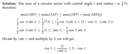

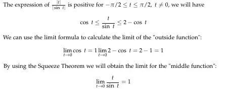

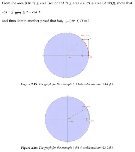

I have been trying this (see the screenshots below). I want to ask whether my answer is enough to proof that $\lim_{t \rightarrow 0^{+}} (\sin \ t)/t = 1$

Figure are really small to read letters properly but the schemes and information given are sufficient to follow your proof which looks very fine and correct.
Refer also to the related:
where I've added an answer based on your question with a more clear scheme to better explain the logic of this proof.
