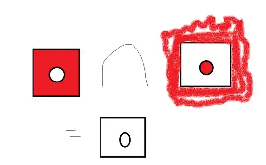

and the identification of $X$ as a square with a disc removed from part (a). I found that $\overline{T^2 - D}$ is $T^2 - D$ plus the boundary of $D$ (the picture on the left), and $\overline{(\mathbb{R}^2 - A)}$ is everything outside the square (including the boundary)[picture on the right]. So if I intersect them, I get that the boundary would be a circle inside a square (where both are not filled in)[the bottom picture]. enter image description here Am I thinking of that correctly? I have no idea what the fundamental group of this would be (I can only guess it's $S^1 \vee S^1$ plus the circle on its own, which doesn't make sense to me. And by class, does that mean all the elements of the fundamental group, $\pi_1(X)$, that are along the boundary of $X$?

    Good work on the earlier parts! I think your calculation for the boundary isn't quite right - $\Bbb R^2$ isn't the ambient space here. You want the boundary of $X$ in $T^2$, which as the question says is the same as the boundary of $D$ - it's the circle on the edge of $D$. Then (c) wants you to identify this circle with a loop and write that loop in terms of the generators you have for $\pi_1(X)$ (up to homotopy). You can also think of this part as "explicitly calculate the map induced on fundamental groups by the inclusion of $\partial X$ into $X$", which will help for (d)... – Izaak van Dongen Jul 30 '22 at 00:00
