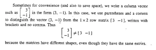

$ y=\begin{bmatrix} x_{1} \\ x_{2} \\ x_{3} \end{bmatrix} = [x_{1},x_{2},x_{3}]\;?$
this gives $y=y^T$
You need to clarify your notation. For example, from page 39 of David Lay's Linear Algebra: enter image description here
Following this convention, $$ y=\begin{bmatrix} x_{1} \\ x_{2} \\ x_{3} \end{bmatrix} = (x_{1},x_{2},x_{3}) \ne [x_{1} \;\;x_{2} \;\;x_{3}]=y^T.$$

  • I also notice we sometimes write something like a column vector but rounded instead of square like ( ) and vertical entries, is this a vector specific notation? When we use these columns and rows are we essentially representing the vector by writing it in a matrix? About never switching between the notations, I have seen definitions of cross-product (I believe) as a matrix product of a row and column vectors. – user37577 Jul 15 '22 at 07:22
  • That ( versus [ preference is just a Math vs. Enginn/CompSci thing: mathematicians tend to use ( since quicker to hand-write; others prefer [. $\quad$ 2. You mean dot product there, not cross product. Yes, and in that context the Euclidean vectors are just being special (slim) matrices. To be clear, I should also point out the (annoyingly) common practice of interchangeably, within the same context, using column and row format (without any entry-separating comma, unlike in that David Lay example) to represent the same Euclidean vector; charitably, this is merely abusing notation.

  • I just find it a bit strange to use both row and column vectors but we can just say that if $V$ is a column vector then $V^T$ is the row vector, the idea of it as a 'co-ordinate representation' instead of the vector itself makes it make more sense, essentially we put the co-ordinates in a matrix, can a tuple like $(1,2,3)$ be equal to a column vector, as you give in your example? – user37577 Jul 15 '22 at 18:32
  • "I just find it a bit strange to use both row and column vectors" If you mean in the same context, and to represent the same Euclidean vector, I said in my previous comment that this is sloppiness. $\quad$ 2. The coordinate-representation thingy was a given from the outset of your Question (yes, a column vector is a slim matrix which is a data structure, and contains x,y,z components of an Euclidean vector), and so what? That is independent of the fact that, if notation is carefully adhered to (as shown in this Answer's final paragraph),

  • then that fake equality that was troubling you doesn't arise; this inconsistency is the thesis of your current Question, and I've shown how it is actually due to notation/misunderstanding. $\quad$ 3. BTW, get rid of the notion that the directed line segment (i.e., arrow) is the real vector and that that 3x1 matrix (i.e., column vector) is just its representation; a vector is an abstract object and both are valid manifestations of it; in $\mathbb R^7,$ which representation is more practical? heh. – ryang Jul 15 '22 at 18:57
