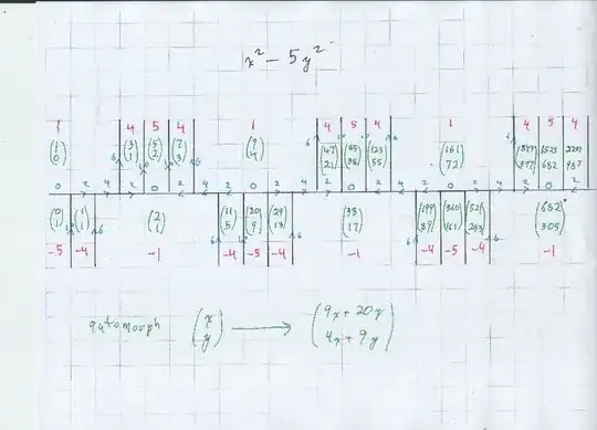

I made another Conway Topograph diagram for $x^2 - 5 y^2$ The $x,y$ pairs are written vertically in green. The values of $x^2 - 5 y^2$ are in pink.
Right, see displayed $11^2 - 5 \cdot 5^2 = -4, \; \; $ $29^2 - 5 \cdot 13^2 = -4, \; \; $ $199^2 - 5 \cdot 89^2 = -4, \; \; $ $521^2 - 5 \cdot 233^2 = -4, \; \; $
Also, $38^2 - 5 \cdot 17^2 = -1, \; \; $ and doubling this gives $76^2 - 5 \cdot 34^2 = -4, \; \; $
If $x$ is one of your alternate Lucas numbers, there is a Fibonacci number $y$ such that $$ x^2 - 5 y^2 = -4 $$ From $x^2 = 5 y^2 - 4, $ we see $x^2 = 5 y^2 - 2^2 = - (2^2 - 5 y^2 )$ and $$ x | 2^2 - 5 y^2 $$ Now if there is any prime $q$ with $q \equiv \pm 2 \pmod 5,$ and if $q | x,$ then $$ q | 2^2 - 5 y^2 $$ However, for any such prime, Legendre symbol $(20|q) = -1.$ This forces $q | y $ along with $q | 2.$
Thus, it is allowed for $x$ to be even (divisible by 2) and divisible by primes $p \equiv 1,4 \pmod 5,$ but not by $q \equiv \pm 2 \pmod 5$ when $q > 2$
On this site, you may have seen this fact: for a prime $r \equiv 3 \pmod 4,$ if $r | u^2 + v^2,$ then both $r|u$ and $r|v$ This is a general thing about the Legendre symbol.

  • Thanks for the solution! There are suddenly a lot you can do once you have the identity $L_{2k+1}^2-5F_{2k+1}^2=-4$ ($L$ for Lucas and $F$ for Fibonacci). I still don't quite understand your diagram and how you obtained the identity, but I guess that's okay. – littletimer Jul 04 '22 at 19:18
  • @littletimer the diagrams are a worthwhile skill to have; introduced in Conway http://www.maths.ed.ac.uk/~aar/papers/conwaysens.pdf while the style I use is depicted in Hatcher https://www.math.cornell.edu/~hatcher/TN/TNbook.pdf The other item is called quadratic reciprocity. – Will Jagy Jul 04 '22 at 20:42
