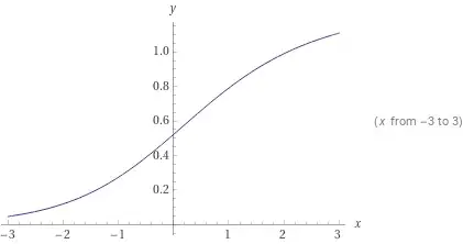

Aka a solution to your question is $-\operatorname{Li_{1 - 0.9}}\left( -e^{0} \right) = -\operatorname{Li_{0.1}}\left( -1 \right) = 0.522270\dots$.
A plot of this would looks like this:
-\operatorname{Li_{0.1}}\left( -1 \right) by wolfram
