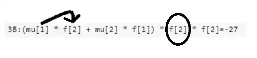

For each of the items labelled 3B: he adds an edge from first mu node to first f node with weight equal to either of first f[i] value outside the first pathesis. enter image description here
in 3B:(mu[1] * f[2] + mu[2] * f[1]) * f[2] * f[2] (mu[1] * f[2] + mu[2] * f[1]) part is for selecting an item in a column which is not multiple of 2.wile the other two columns have multiple of 2.3 in 3B is C(3 1) for permuting this column either at start , middle or end.

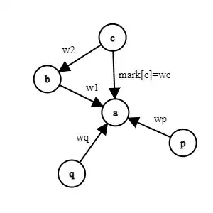

Tiangle counting:
Note Neither for I: labeled values nor for 3B: labeled values the graph is required. The graph is being constructed for 6A: values

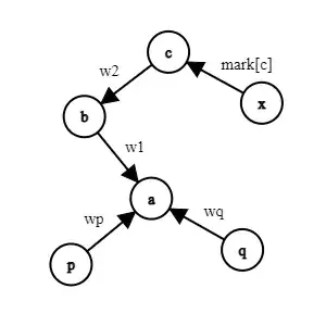

mark[c] denotes wheather it has been traversed earlier as first distance. if yes it has value equal to weight of edge used to traverse to it. enter image description here
Before traversing node a, for each edge incident on a we mark the source node in by weight and clear it once traversing a case is complete. So mark[c] to have a valid value node x has to be node a. Hence a triangle.
w1 * w2 * mark[c] is equivalent to w1 * w2 * wc
