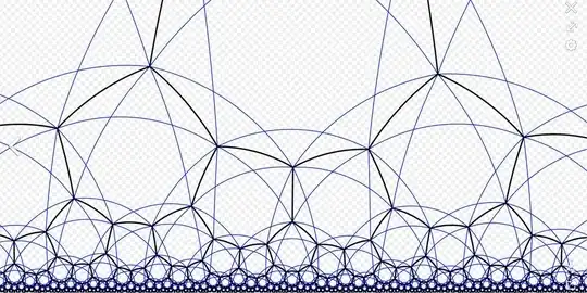

From what I can see here, the heptagons are clearly of different areas as they move away from the lower boundary, so if I want a Poisson point process in the hyperbolic plane, each area of equal Lebesgue measure (e.g. two equal area heptagons) should have the same expected number of points in, so points should be much more dense near the boundary $y=0$.
Here is a stellated regular heptagonal tiling of the model. From Wikipedia
