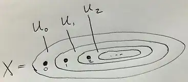

Here is an example of a local homeomorphism which is not just a covering map with points from the domain removed (nor is it of the form $\bigsqcup U_i \to X$ where $U_i \subseteq X$ are open subspaces).
Let $X= \Bbb{Z}_{\geq 0}$ with open sets $U_n = [n, \infty)\cap X$ for $n \in \Bbb{Z}$. The open sets are nested $X = U_0\supsetneq U_1 \supsetneq \cdots$, so that any open cover of $X$ contains $X$ itself. Here is a picture:
Nested space
Because any open cover of $X$ contains $X$ itself, its covering spaces are all of the form $\bigsqcup_{i \in I} X \to X$. Yet we can easily construct a local homeomorphism not of this form by gluing two copies of $X$ together along any of the $U_i$. (The result is a connected space which is not homeomorphic to $X$, so it cannot be extended to a covering map.)
