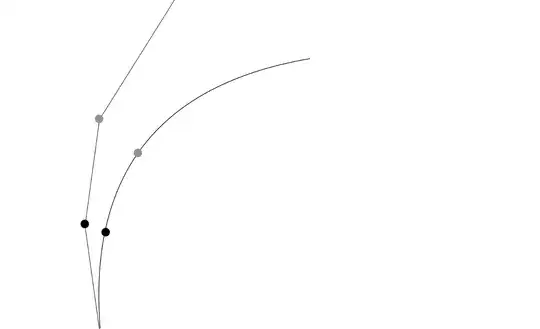

Here is an illustration for ${\bf y}_n, {\bf y}(t) \in \mathbb{R}^2.$ The points of same color denote the same time.
Note that the tangent for the discrete system at $t_n$ is NOT ${\bf F}(t_n,{\bf y}(t_n))$ (about the function value y), but ${\bf F}(t_n,{\bf y}_n)$ (about the sequence y), according to the definition of the Euler method$^1$; and so the tangents at the points of the same color are, actually, different (the same t, F, but different y, so different F(t,y); the equs 1.1, 1.4 are from Iseries's book, the right side of which are ${\bf F}, {\bf f}$ above respectively--to clarify the difference between the notations here and thereof).
(Non-bold f (the right side of the continuous), F (the right side of the discrete), y above are less strict notations. $t_n, t$ are the same as long as they equal; there is only one time-(real)numbering system here.)

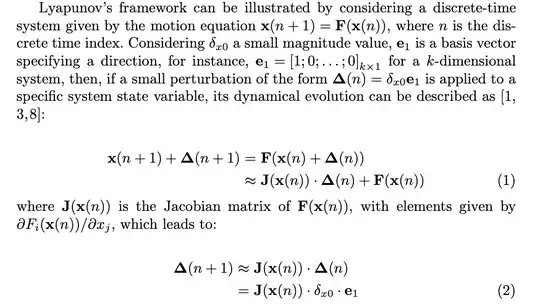

A possible answer (Soriano, A Method for Lyapunov Spectrum Estimation using Cloned Dynamic):
We simply use Taylor expansion for $f(t, y+\delta y)$. Besides, note that in contrast with my thought above [3], no fixed point is required for the linearization of the system for the definition of LEs; for the none-derivative first term in the Taylor expansion is eliminated using the recurrent relation $y_{n+1}=f(y_n)$, not the fixed point $y = f(y)$.

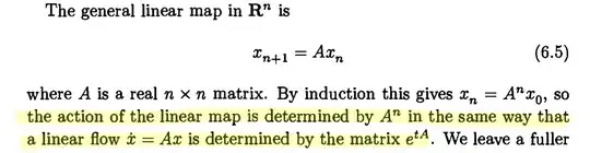

The following excerpt from ch6 of Glendinning's book supports my guess:

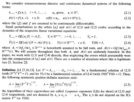

However, the excerpt of Soriano's paper, as well as Def 2.1 in Dieci, 1995 below seems to suggest that we use the Jacobian of f for defining LEs.
