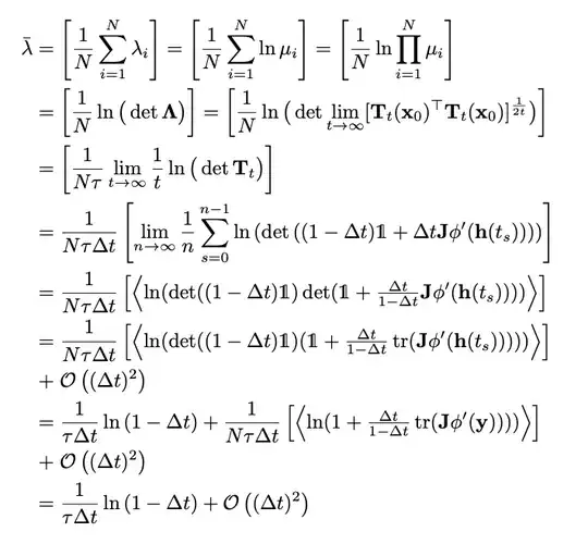

(This section is unnecessary for answering the question:) An example of calculation is given as (note that $\mu_i$ below is actually eigenvalues (specifically, of an Oseledets matrix $\Lambda$) denoted as $\lambda_i$ above. I hope to know what is more general than the example):
For this example in particular, why $$\prod_i \mu_i = \det(\Lambda)?$$
My thought is that we can transform $\Lambda$ to a diagonal matrix $D$ with a unitary matrix $P$:
$\Lambda = P D P^{-1},$
where $D_{ii} = \mu_i$ (or the eigenvalues in different order), $\det(P) = \det(P^{-1})=1$, and so
$$\det (\Lambda) = \det(P) \det (D) \det(P^{-1})=\det (D) =\prod_i \mu_i.$$
