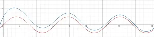

Can this definition be extended to the case where the "attracting" point depends in time (so that $x^*(t)$ is now an arbitrary solution) ? For example, in the below figure let the red line depicts $x^*(t)$, the attracting point at time $t$. Then the blue line shows $x(t)$ approaching $x^*(t)$ at every time (in the sense that the gap between the red and blue never grows).
To be a bit more formal, I want $x(t) = x^*(t)$ for all $t \geq 0$ if $x(0) = x^*(0)$, and if instead we have $\left | x(0) - x^*(0) \right | < \delta$ then for all large enough time values $t \geq t_0$ we have $\left | x(t) - x^*(t) \right | < \epsilon$.

As @Aphyd points out, this could be done by making a coordinate transform so that a point moving along the trajectory x(t) becomes stationary, while other points (such as x*(t)) moves with the same velocity relative to x(t). Interestingly some systems remain topologically unchanged under such transformation, such as $x'=x, y'=y$. Most of the time a system's stability or topological structure is completely determined by its nonwandering set, which is just a generalized form of stationary points.
  • I appreciate the response. Perhaps this is somewhat trivial but can you provide an example as to how the coordinate transform can be done? Under what conditions does such a transform exist? – Bryden C Jun 05 '22 at 02:12
    @BrydenC Given a system $\phi'0(x)=X(x)$, consider a (possibly nonautonomous) system of the form $\psi'_0(x)=Y(x,t_0):=X(\phi{t_0}(x))-X(\phi_{t_0}(x_0))$. Solving the functional equation $\psi_t(h(x))=h(\phi_t(x))$ for $h$ yields the desired coordinate transform. Only in special cases the solution for $h$ is a homeomorphism. – Chang Gao Jun 06 '22 at 02:13
