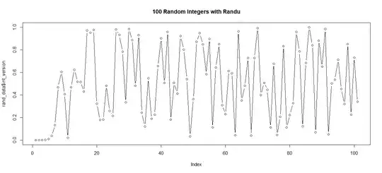

I am interested in learning more about Random Number Generation. Recently, I found out about an algorithm called "RANDU" (https://en.wikipedia.org/wiki/RANDU), which was an early algorithm for generating random numbers.
Using the R language, I implemented it below:
v = rep(0,100)
v[1]=3
for (j in 1:100) {
v[j+1]=(65539*v[j])%%(2^31)
i = 1:101
range01 <- function(x, ...){(x - min(x, ...)) / (max(x, ...) - min(x, ...))}
rand_data = data.frame(i,v)
rand_data<span class="math-container">$int_version = range01(rand_data$</span>v)
head(rand_data) i v int_version 1 1 3 0.000000e+00 2 2 196617 9.201486e-05 3 3 1179675 5.520835e-04 4 4 5308497 2.484362e-03 5 5 21233907 9.937413e-03 6 6 79626969 3.726522e-02
plot(rand_data$v, type = "b", main = "100 Random Real Numbers with Randu")
Naturally, this lead me to the following question:
  • How do we know that these 100 numbers are truly random - Is there some mathematical proof for this?
  • Why does this RANDU algorithm work - Is there some mathematical proof for this?
I tried to look into this, but I couldn't find a straight answer. Can someone please provide any comments?
Thank you!
Note: Apparently you can use the Chi-Square Test to find out if a random sequence of numbers has a "uniform distribution" (https://stats.stackexchange.com/questions/406406/test-of-uniform-distribution-using-ks-test-and-chi-square-in-r, Is there a simple test for uniform distributions? ... but I am not sure why the Chi-Square Test can detect if random numbers have a uniform distribution). I performed this test in R:
ks.test(rand_data$int_version, "punif", min(rand_data$int_version), max(rand_data$int_version))
One-sample Kolmogorov-Smirnov test
data: rand_data$int_version D = 0.079507, p-value = 0.5457 alternative hypothesis: two-sided
Based on these results, the p-value is significantly greater than a standard tolerance level (e.g. alpha = 0.05) - therefore, there is sufficient statistical evidence to accept the Null Hypothesis and conclude that these random numbers correspond to a uniform distribution.

    They are not truly random, but instead pseudo-random. And the algorithm has flaws such as that illustrated in the 3D plot in the Wikipedia article – Henry May 28 '22 at 20:04
    Even defining what it means to be "random" is very tricky, but, being a deterministic process, we usually don't call it random. – Thomas Andrews May 28 '22 at 20:05
    Knuth, The Art of Computer Programming: RANDU is a linear congruential random number generator, and a pretty bad one at that. – gnasher729 May 28 '22 at 20:19
