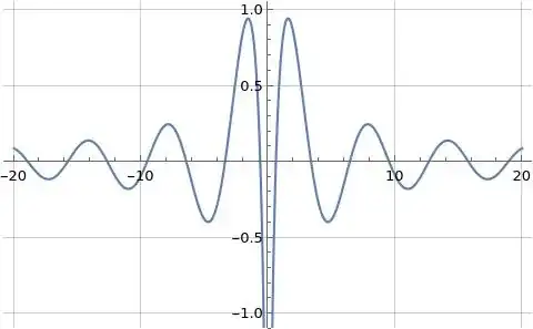

Figure (1) below illustrates the function $(\text{Ei}(i x)+\text{Ei}(-i x))$, related to the term of formula (11) above for $f_1(x)$, has a branch point at $x=0$, is an even function of $x$ with a decaying oscillation around the real axis as $|x|\to\infty$, and $\underset{x\to\infty}{\text{lim}}(\text{Ei}(i x)+\text{Ei}(-i x))=0$.
Illustration of (Ei(i x)+Ei(-i x))
Figure (1): Illustration of $(\text{Ei}(i x)+\text{Ei}(-i x))$

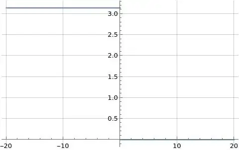

Figure (2) below illustrates the function $\text{Ci}(x)$, related to the term of formula (18) above for $f_1(x)$, has an undesirable branch cut along the negative real axis.
Illustration of $Im(Ci(x))
Figure (2): Illustration of $\Im(\text{Ci}(x))$

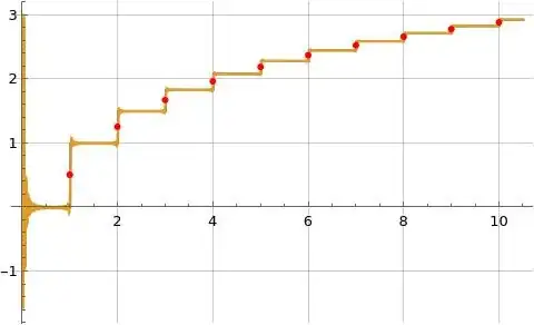

Figure (3) below illustrates formula (6) for $\tilde{h}(x)$ above in orange overlaid on the blue reference function $h(x)$ defined in formula (3) above where formula (6) is evaluated at $K=20$. The red discrete evaluation points in Figure (3) below illustrate the evaluation of formula (6) for $\tilde{h}(x)$ at integer values of $x$.
Illustration of formula (6) for}h(x)
Figure (3): Illustration of formula (6) for $\tilde{h}(x)$
