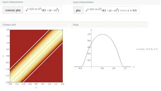

$$U(t,x) = \exp\left(1-\frac{1}{(1-(x-t)^2)}\right)\theta(1-(x-t)^2) \tag{Eq. 8}\label{Eq. 8}$$
it will show to be compact supported in space as it moves in the time variable, fulfilling the standard wave equation with a velocity $c=1$: $$\left(\frac{1}{c^2}\frac{\partial^2}{\partial t^2}-\nabla^2\right)U(t,x)=0 \overset{c=1}{\Rightarrow} U_{tt}-U_{xx}=0 \tag{Eq. 9}\label{Eq. 9}$$
Here the partial equation doesn't show the term $(T-t)$, but it does make sense if the countour plot of \eqref{Eq. 6} is viewed:
Eq 8 plots
It is only compacted-supported in space and it is still never-ending in time.

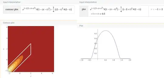

But if I test this modified version of \eqref{Eq. 8} mixed with the terms of \eqref{Eq. 2}:
$$E(t,x) = U(t,x)\cdot \frac{1}{4}(2-t)^2\,\theta(2-t) = \exp\left(1-\frac{1}{(1-(x-t)^2)}\right)\theta(1-(x-t)^2)\cdot\frac{1}{4}(2-t)^2\,\theta(2-t) \tag{Eq. 10}\label{Eq. 10}$$
where this time it can be seen in its plot that is indeed behaving as also a finite duration solution in time:
Eq 10 plots
It could be verified that is solves the equation: $$E_{tt}-E_{xx}+\frac{4}{(2-t)}E_{t}+\frac{6}{(2-t)^2}E = 0 \tag{Eq. 11}\label{Eq. 11}$$ within the domain \eqref{Eq. 10} is different from zero (see here). So again the terms $(T-t)$ are required for having finite-duration solutions.
I beforehand know that some of these functions should be defined piecewise because has a undefined value, as example: $$ f(t) = \begin{cases} \exp\left(\frac{t}{(t-1)}\right),\quad t < 1 \\ 0, \qquad t\geq 1 \end{cases} \tag{Eq. 12}\label{Eq. 12}$$ instead of the one-line version of \eqref{Eq. 4}, so I ask you now to forgive this shortcut for now: the functions still continuous on these points and for me are easy to work with them finding their differential equations on this way (I have a extended discussion of this here), but if this annoying you, please just assume it is defined piecewise such as the function is zero in the undefined point.
