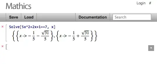

Mathics is “a free, light-weight alternative to Mathematica” built using Python and SymPy. It has an online version:
Mathics web page screenshot
  • link not working – Nike Dattani Oct 10 '18 at 23:27
    @user1271772 Fixed the home page link. I took its new URL from the source code repository at https://github.com/mathics/Mathics. Wayback Machine view of older home pages: https://web.archive.org/web/20180404092800/http://www.mathics.org:80/. – Rory O'Kane Oct 12 '18 at 05:54
  • Is it true that we cannot copy and paste in the Mathics online version? Also, it does not actually do any calculations, it just allows you to type in commands that look like Mathematica formatted commands? – Nike Dattani Oct 12 '18 at 15:07
  • @user1271772 The online tool does have those features. As the message at the bottom when you open the page says, press Shift+Return to submit your calculation. Pressing Return just creates a new line within a calculation – this mimics the interface of Mathematica. As for copy and paste, I can copy and paste calculations and results fine in Firefox. – Rory O'Kane Oct 17 '18 at 07:30
