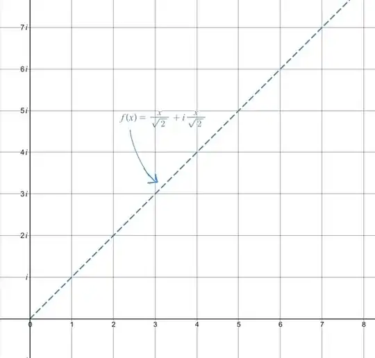

The most blaring issue here is my assumption that $\lim_\limits{x\to\infty} \sqrt{i} \cdot x = \infty$. This is nonsense when you look at it this idea of the limit on the complex plane.
The complex function $f(x) = \sqrt{i} \cdot x$ can be expressed as $f(x) = \frac{x}{\sqrt2} + i\frac{x}{\sqrt2}$. To help visualize this, I plotted this on a graphing calculator, which gives the following:
As you can see, as this x approaches infinity, this function does approach an infinity; the function approaches the corner of the real-imaginary plane $\infty + i\infty$. However, this is not the same as $\infty$, which represents approaching the edge of the horizontal real number line. To put this more rigorously, this picture shows that $\lim_\limits{x\to\infty}\sqrt{i}\cdot x \neq \lim_\limits{x\to\infty}x$.
But why did this proof still work? It clearly returned the right value for both integrals. Is this step really as nonsensical as it seems? And if not, what kind of implications could that carry?

  • You use Cauchy which connects the two integrals (one on the reals and one on the complex path you get after the naive change variables - technically you take the integrals from zero to endpoint of modulus $R$ and connect those by a circle arc say and show that the integral on that goes to zero as $R$ goes to infinity) – Conrad May 01 '22 at 14:11
  • That makes sense, I’ve seen similar approaches when looking into other ways of proving this. But I’m curious as to why my approach works anyways. Did I just get lucky? Or is there something deeper to it? – Mailbox May 01 '22 at 14:16
    $e^{-z^2}$ is governed at infinity by the real part of $z^2$ and in this case it happens that goes to zero in the domain we consider which is the first octant, except on the boundary $x=y$ but the integrand goes to zero fast enough on the circle arc connecting the reals with $x=y$ at level $R$ so the integral still goes to zero; so it all has to do with estimates that here are good enough - this is a common method and works precisely when you have estimates that lead to the integral on the connecting path being zero in the limit – Conrad May 01 '22 at 14:29
