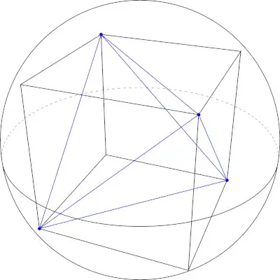

Inscribe the regular tetrahedron in a cube, then circumscribe a sphere on the cube.
A regular tetrahedron has a circumsphere
    Thanks, that is a known idea (inscribe the regular tetrahedron in a cube), and intuitively clear. However, proving formally that the tetrahedron is inscribed in a cube, is not entirely obvious I think, at least not without computation. (I upvoted anyway, just mentioning my thoughts.) – Asaf Shachar Apr 26 '22 at 20:20
    Starting from a cube and "taking alternate vertices" we recover a regular tetrahedron because each edge is a diagonal of a square and the cube's faces are congruent. Granting that a regular tetrahedron is unique up to scaling and Euclidean motion (which admittedly may be a large leap!), every regular tetrahedron is inscribed in a cube. – Andrew D. Hwang Apr 26 '22 at 21:00
    OK, next what to do with a non-regular tetrahedron? – GEdgar Apr 26 '22 at 21:21
    @GEdgar This approach naturally doesn't generalize, but the question body does stipulate regular (though the title doesn't). Given Asaf's mention of "high-school students," this picture seemed worth mentioning as a complement to your elegant (+1) computation. – Andrew D. Hwang Apr 26 '22 at 21:44
    You are right, the OP text does specify "regular". That makes the solution easier, as your solution shows. – GEdgar Apr 27 '22 at 00:36
  • How does this 'prove' a sphere gets admitted from a tetrahedron? The points don't intersect – Barb Apr 27 '22 at 08:26
    @Barb The cube is uniquely determined by the (regular) tetrahedron and the sphere is uniquely determined by the cube. Each vertex of the tetrahedron is a vertex of the cube and each vertex of the cube lies on the sphere. – Andrew D. Hwang Apr 27 '22 at 12:33
    Why is the fact that a cube has a circumsphere any more obvious than that a regular tetrahedron has one? – Kyle Miller Apr 27 '22 at 16:21
  • @KyleMiller For me, it's the three orthogonal planes of reflection symmetry parallel to pairs of opposite faces: The resulting group of Euclidean motions acts transitively on the cube's vertices, so each vertex is equidistant from the point where the planes meet. – Andrew D. Hwang Apr 27 '22 at 20:12
  • @AndrewD.Hwang oh! I thought proof would require you to prove that it does. I mean it should be obvious if $V = \frac {a^3}{6\sqrt 2}$ is a radical so removing it you have $V = \frac {2^.5a^3}{12}$. Its like me saying at this point, every square has a circle so a sphere must exist but wouldn't I need to show that and not just say it or draw it for it to be considered proof. – Barb Apr 28 '22 at 07:02
    @Barb My prior comment to you was a sequence of assertions addressed to your note that "the points don't intersect." <> The proof itself may be fleshed out using geometric observations ("alternate vertices" and "three orthogonal planes of symmetry") noted above, but the spirit of this answer was Behold!. – Andrew D. Hwang Apr 28 '22 at 12:09

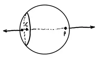

Here's a sketch of a proof that is visually obvious, if you have the right pictures in your head, but to make it precise it seems like it requires some fancier ideas (continuity and some limiting processes). I'll just share it in case it's useful somehow.
Given 3 non-collinear points in 3-dimensional space, then there is a circle that contains those three points (there is a plane that contains the three points, and inside that plane they are the vertices of a triangle, so we can take its circumcircle).
Given a circle in 3-dimensional space, consider the line that passes through its center and that is orthogonal to the plane that contains the circle. For every point on this line (except the circle's center) there is a sphere that contains the circle and this point. (We can construct it by considering the sphere as a surface of revolution about the line, then reasoning about the 2D cross-section.) Here's an illustration, showing a sphere containing the circle and its two points of intersection with the orthogonal line, and observe that, holding the circle constant, the sphere is purely a function of the intersection point P.
A sphere containing a circle and a point P on the line through the circle's center.
Now, given four points in 3D space that form a tetrahedron (it does not have to be a regular tetrahedron, just non-degenerate: every triple of points is non-collinear and the four points do not lie in a plane), take three of them and form the circle and its orthogonal line as above. The fourth point lies to one side of the plane that runs through the circle -- cutting the line at the center point of the circle, take the ray that is on the same side of the plane as the fourth point. For a point on this ray close enough to the circle's center point, the fourth point is outside the corresponding sphere, and for a point on this ray far enough away from the circle's center point, the fourth point lies inside the corresponding sphere. Therefore, there is some intermediate point such that the fourth point lies on the corresponding sphere. This is the circumsphere of the tetrahedron.
To be able to argue in this way about "close enough to one end of the ray or another," what you need is to see that the limit of the spheres in both cases is exactly the plane that contains the circle, and in either case what's "inside" the "sphere" is an entire half space bounded by the plane.
Kyle Miller
  • 20,247
  • For every point on this line […] there is a sphere that contains the circle and this point. This doesn’t seem right to me, unless by “contains” you mean that the sphere just encloses the circle? Otherwise there should only be two points on that line that are contained by a sphere that contains the circle (the poles, if the circle is the equator). – Seb Apr 27 '22 at 15:05
    @Seb By "contains" I mean "contained in the set of points that constitute the sphere." I've added an illustration -- note that every intersection between a sphere and a plane gives a circle (or a point, if it's tangent), not just the plane through the sphere's center. – Kyle Miller Apr 27 '22 at 15:27
  • Great illustration, that definitely clears up my confusion. I was making the unwarranted assumption that the circle and the sphere are concentric. – Seb Apr 27 '22 at 15:37
