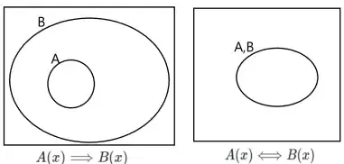

![![enter image description here
In the above Venn diagrams, element $x_1$ of set $A$ represents solution $x_1$ of equation $A(x).$ So:
  • $A(x){\implies}B(x):\;$ whichever $x$ satisfies equation $A(x)$ also satisfies equation $B(x)$
  • $A(x){\kern.6em\not\kern-.6em\implies}B(x):\;$ some $x$ satisfies equation $A(x)$ but not equation $B(x)$
  • $A(x){\iff}B(x):\;$ equations $A(x)$ and $B(x)$ have the same solution set. \begin{gather}\lg x = 3 \implies \lg x^2 = 6\implies x=\pm1000\tag1\\ \lg x^2 = 6 \kern.6em\not\kern-.6em\implies \lg x = 3\implies x=1000\tag2\\ x^2 = 25 \kern.6em\not\kern-.6em\implies x = 5\tag3\\ x^2=25\implies |x|^2=25\implies |x|=5\implies x=\pm5\tag4\\ \lg x^2 = 6 \implies \lg |x|^2 = 6\implies \lg |x| = 3\implies x=\pm1000\tag5\end{gather}
Of the eleven operations above, only the third and fifth ones discard solution(s), so they are invalid steps.
The other nine operations do not discard any required solution, and are valid steps. However, valid operations may nevertheless create extraneous solution(s), as in $(1)$ above. I wrote here about how to avoid extraneous solutions (it's got to do with $‘\iff$’), but it is safer (less carelessness-prone) to just treat obtained solutions as merely candidate (provisional) solutions, then sift out those that fail to satisfy the given equation. Thus, extraneous solutions are not really a problem.
