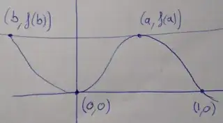

We can then take $a\in(0,1)$ such that $f(a)$ is maximal and let $b\neq a$ with $f(b)=f(a)$. Then $b$ cannot be inside the interval $(0,1)$: in that case, the tangent at the point $c$ of the interval between $a$ and $b$ such that $f(c)$ is minimal cuts the graph of $f$ in at least $3$ points. There are two options for $b$.
If $b>1$, we can find a contradiction: in this case $f(1)=0$ is a local minimum of $f$. Now using the fact that for any $\varepsilon$ there is some $x\in(0,\varepsilon)$ with $f'(x)\in(0,\varepsilon)$ (you can prove it using that $f(0)=f'(0)=0$ and $f(x)>0$ in $(0,1)$), we can find a small $x>0$ such that its tangent line intersects the graph of $f$ at two points near $(1,0)$.
So $b<0$ and $f$ does not have a local minimum at $1$. The graph of $f$ would look something like this:

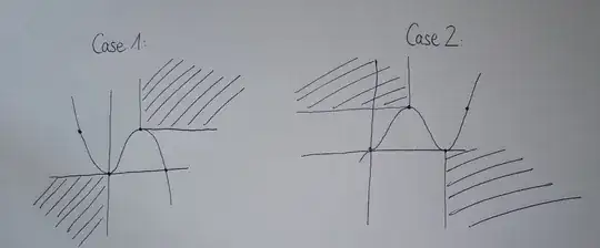

Assume $x<g(x)$ w.l.o.g. Because of the mean value theorem, there exists a $\xi\in(x,g(x))$ (which especially means $\widetilde{f}(\xi)\neq 0$) with $f'(\xi)=f'(x)\Leftrightarrow\widetilde{f}'(\xi)=0$ using the upper equation. Assume $\widetilde{f}$ is only positive in $(x,g(x))$ w.l.o.g. Let $\xi\in(x,g(x))$ be the value of the global maximum in $(x,g(x))$. It is unique since for two different maxima $\xi_1,\xi_2\in(x,g(x))$ with $\xi_1<\xi_2$ w.l.o.g., there would be a $\zeta\in(\xi_1,\xi_2)$ with $\widetilde{f}'(\zeta)=0$ and $\widetilde{f}(\zeta)<\widetilde{f}(\xi_1)=\widetilde{f}(\xi_2)$. Due to the intermediate value theorem, the horizontal tangent through $(\zeta,\widetilde{f}(\zeta))$ would intersect $\widetilde{f}$ also somewhere in $(x,\xi_1)$ and $(\xi_1,g(x))$. This also implies $g(\xi)\notin[x,g(x)]$. We are left with two cases for which we have to derive a contradiction:
Case 1: Assume $g(\xi)\in(-\infty,x)$, then $f>0$ in $(-\infty,0)$ and $f<f(\xi)$ in $(\xi,\infty)$.
Case 2: Assume $g(\xi)\in(g(x),\infty)$, then $f>0$ in $(g(x),\infty)$ and $f<f(\xi)$ in $(-\infty,x)$.
The argumentation for both cases is analogous and done in the other answer.
