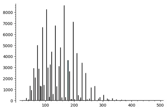

But this clustering extends over larger swaths of integers. Consider the integers in $[1000000,1100000]$. These $10^5$ integers have among them a total of just $69$ different stopping times, ranging from $20$ to $501$. Among those times, just $8$ of them account for over $50\%$ of the integers: $t = (72, 90, 103, 121, 134, 152, 165, 196)$. By contrast, $16$ of those $t$ values occur $10$ or fewer times, accounting for just $71$ of the integers in this range.
Within the range of values of $t$ taken, just $14\%$ are found, and just $1.66\%$ account for more than half the integers in the range. And as one looks at the same range sizes in larger integers, the clustering becomes more pronounced:
$$\begin{array}{c|c|c|c|c} \text{Range Start} & \text{Range of } t(n) & t \text{ values} & t \text{ values for 50%} \\ \hline 10^5 & [17, 382] & 167 & \sim40 \\ \hline 10^6 & [20, 501] & 69 & 8 \\ \hline 10^7 & [39, 618] & 48 & 5 \\ \hline 10^8 & [50, 686] & 40 & 4 \\ \hline 10^9 & [48, 803] & 34 & 4 \\ \end{array}$$
Now, obviously we shouldn't expect homogeneity of any sort. But this sort of clustering seems to be out of the realm of what we might expect. Over $20 \%$ of the integers $10^7 \leq n \leq 10^7 + 10^5$ all have the same total stopping time: $114$. They're not sequential, but that's a crazy statistic.
Does anyone know of an explanation--heuristic or otherwise--for this heavy clustering of the total stopping times?
The image below is a histogram of $t(n)$ values for $1000000 \leq n \leq 1100000$

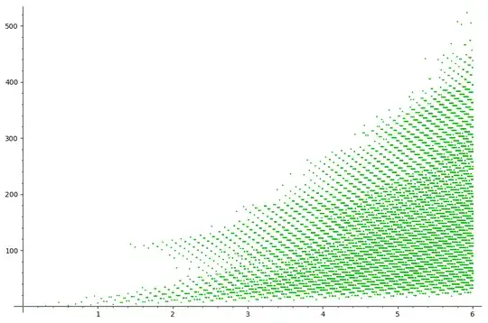

All right, I have found at least a partial answer. Specifically, a heuristic explanation for the clustering. It comes from looking at the pattern of curves in the plots you can see on Wikipedia, and thinking, "Wait, those curves look kinda logarithmic, don't they?" Here's a plot of $t(n)$ against $n$, on a log scale, for $1 < n \leq 10^6$:
Look at that pretty grid! And as a bonus, it's Fibonacci-based. The shallowest upward "lines" are increases of the stopping time by $3$; the most obvious downward lines are decreases by $5$; and you can further draw lines differing by $8$ and $13$.
What, then, is the heuristic argument? Well, let's imagine, for a moment, that this grid were composed of a single point at each node. As $n$ gets larger, a single point "covers" more and more integers. A single pixel near the left--say, the one at $(27, 111)$, has a "width" of one integer. OTOH, if we pick a single pixel somewhere on the right--one of the many points in the general range of $(10^5, 200)$--has a "width" of around $3000$ integers. Which of those integers would the line actually cross? Well, perhaps all or most of them!
Hence, we expect larger and larger clusters as $n$ increases, because of the empirical patterns we can see in the plot above. And every value of $t(n)$ will repeat periodically (on a log scale), until $n > 2^{t(n)}$ (after which that value can no longer be a stopping time).
