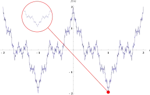

Assuming you mean a function that is not monotonic anywhere, but still integrable, there is the Weierstrass function, which is continuous everywhere (and thus integrable everywhere), but is nowhere monotonic.
