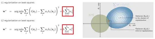

In Machine Learning optimization problems - a "regularization" term is often added to the optimization problem to reduce overfitting:
I have noticed that in the case of the L2-Norm regularization, this term (i.e. a function) can be considered as a Convex Term as it is basically "quadratic" in nature.
My Question: In the L2-Norm case, the optimization problem without this regularization term is likely a Non-Convex problem - but we then add a Convex Term to this problem. Do we know if doing this (i.e. adding the Convex Term to a Non-Convex Optimization Problem) automatically makes the optimization problem as Convex?

Yes, adding a large enough convex term can make a problem convex. For example, consider the nonconvex function $-x^2$ and the convex function $x^2$. For constant $\lambda \ge 1$, the sum $-x^2 + \lambda x^2=(\lambda-1)x^2$ is convex.
This is also a standard trick in binary quadratic programming, where $x_i$ is a binary decision variable and the objective is to minimize the multivariate quadratic function $$\sum_i \sum_j q_{ij} x_i x_j + \sum_i c_i x_i$$ subject to linear constraints. Let $\lambda$ be the absolute value of the smallest (negative) eigenvalue of $Q=(q_{ij})$. Then adding $\lambda(x_i^2-x_i)$, which is $0$ when $x_i$ is binary, makes the objective function convex.
