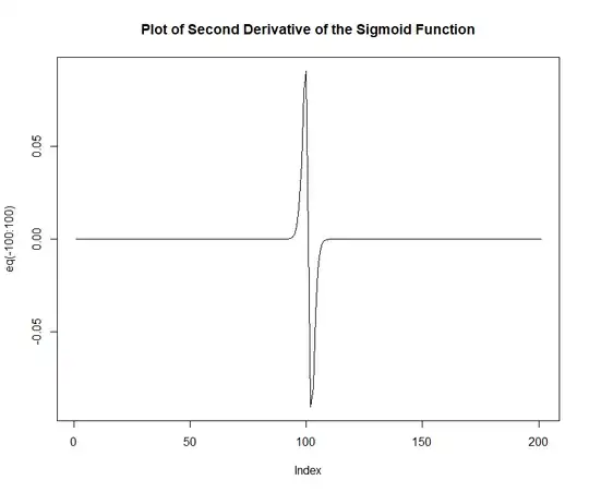

Using the R programming language, I plotted the second derivative of the Sigmoid Function and we can see that it fails the Convexity Test (i.e. the second derivative can take both positive and negative values):
e = 2.718
eq = function(x){ (-e^-x)* (1+e^-x)^-2 + (e^-x)(-2(1+e^-x)^-3 *(-e^-x))}
plot(eq(-100:100), type='l', main = "Plot of Second Derivative of the Sigmoid Function")

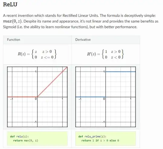

On it's own, the ReLU function is said to be Convex. Mathematically, we can show that compositions of Convex Functions can only produce a Convex Function (The composition of two convex functions is convex). I understand that the composition of two Convex functions can produce a Concave Function - but still, the composition of two Convex Functions can not produce a "classic type of Non-Convex Function" (e.g. a function with several local minima and saddle points).

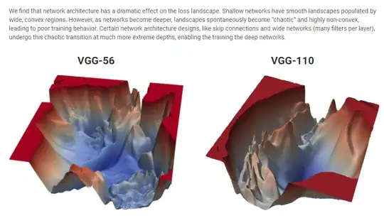

For example, below we can see the Loss Surfaces of (Modern) Neural Networks that clearly look Non-Convex:
(https://www.cs.umd.edu/~tomg/projects/landscapes/)
