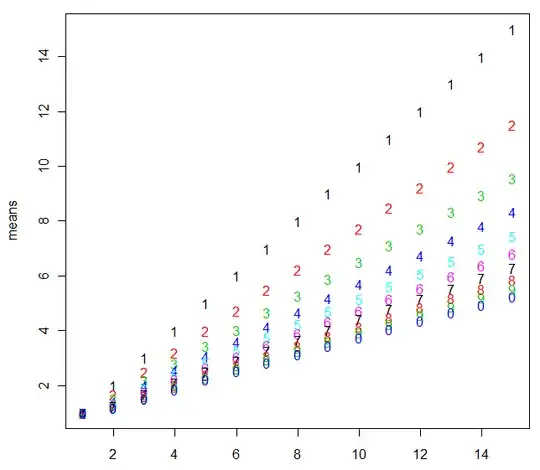

Plotting this (totals on the horizontal axis, expectations of maximum values on the vertical axis, and numbers of parts as coloured digits) looks like
The expectations of maximum values seem to grow close to linearly to the totals, but to fall more slowly than inversely to the number of parts.
