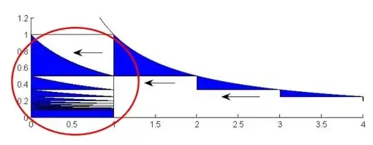

A graphical proof (with its advantages and drawbacks : "is it really a proof ? etc.) needing only to know that $\ln(k)$ is the area under the curve of $y=\dfrac{1}{x}$ taken from $x=1$ to $x=k$ :
Indeed, if we set
$$E_n:=C_n-1=\sum_{i=2}^n \dfrac{1}{i}$$
$E_n$ can be visualized as the sum of the areas of the blue curvilinear right triangles from $1$ to $n$ taken as negative areas. You can slide them (without overlap) in order they fit into the square $[0,1] \times [0,1]$. As they are considered negatively, it is the complement set, the white part, that represents the sequence ; this answers the question because the limit set, a kind of fractal set, has a limit area slightly larger than $0.5$... ($\gamma \approx 0.577...$) due to the concavity of the curvilinear triangles.
