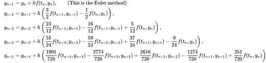

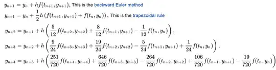

$(2)$ Another question is from linear multistep methods. Is there any way to quickly come up with the coefficient of those methods, like for $3$ step method, the coefficients $\frac{23}{12},-\frac{16}{12}$ and $\frac{5}{12}$. It's hard to memorize and can't derive the whole formula in exam time.
