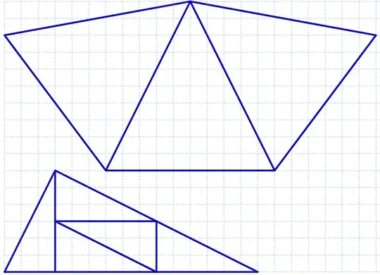

  1. Is there any triangle that can be cut into 5 mutually congruent pieces? If the answer is "yes" how does one characterize such triangles? What if we restrict the pieces to be convex?
  2. Is there any convex pentagon that can be cut into 3 mutually congruent pieces?

    A right triangle with legs in the ratio 2:1, maybe? – Oscar Lanzi Jan 14 '22 at 01:08
drawing
Worth a thousand words, they say.
Ivan Neretin
  • 13,429
  • thanks very much. i had indeed overlooked some basic possibilities while trying to dissect pentagons and hence asked the question. but then that is math! – Nandakumar R Jan 14 '22 at 12:20
