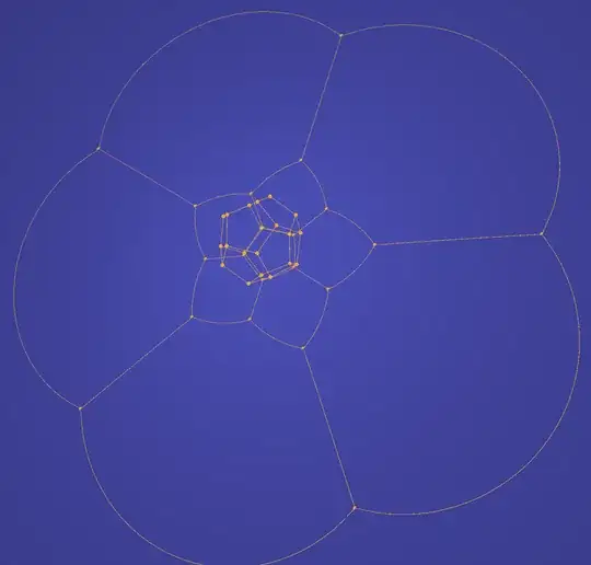

I'm going to ask what I think is surely a silly and simple question but I can't for the life of me work this out. I am interested in stereographically projecting a dodecahedron to the plane (in an interactive computer program). This has been implemented and here is an example image:
Stereographic Projection of Dodecahedron
Now, imagine that there were inscribed circles on the faces of the dodecahedron whose centres were the centres of the faces and which were tangent to the edges of the dodecahedron (their centres would be the red points in the image above). Stereographic projection projects circles to circles and so in the regions of the plane above we would expect to see inscribed circles.
We know that these circles would be tangent to the sides at the projections of the points which lie halfway along each edge of the dodecahedron and on this basis I computed these circles. However, the outcome is this:
Bad Outcome!
As you can see, the inner circles are indeed tangent to the sides of the regions. However, the outer regions' circles are rather messy and definitely do not lie in the regions. Why might this be?

  • Shouldn't a stereographic projection be conformal? Your mapping of the dodecahedron's edges don't seem to have the angles of regular pentagons. – Malice Vidrine Jan 01 '22 at 02:02
  • Are you sure your projection is correct? The circle through all vertices of a regular polygon should also be projected to a circle, which is clearly not happening. Also compare your projection to the one on Wikipedia. – Nij Jan 01 '22 at 02:02
    I agree. The edges of the dodecahedron could be mapped to circular arcs instead of straight lines. – Oscar Lanzi Jan 01 '22 at 02:12
  • Aha! This was the silly assumption! I think (/hope?) that the projection of the individual vertices is correct but that the error I made was in assuming that once projected onto the plane, I could simply draw straight lines between these points to get the projection of an edge! Didn't think that straight lines might not be projected to straight lines... – Isky Mathews Jan 01 '22 at 02:14
  • Try using a flashlight on a ruler in a dark room and observe the shadows to see how lines curve under stereographic projection. Cheers – Jair Taylor Jan 01 '22 at 03:48

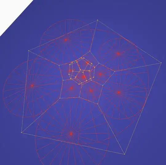

I thought I'd just update everyone by saying that the comments precisely sorted out my problem: I had been projecting the vertices correctly and then for some reason assuming I could just draw straight lines between them. Instead, of course, the straight lines are in general projected to circular arcs and having sorted this out I got the interactive simulation to work. Here is an image:
A projected dodecahedron
and here is a link to the website where this projection is shown live where the controls are:
  1. Rotate the dodecahedron around a horizontal axis by moving your mouse in the $x$-axis of the screen and rotate it around the vertical axis by moving your mouse in the $y$-axis of the screen.
  2. Click and drag to rotate your viewpoint.
  3. Middle-click (with your scroll-wheel) to pan your viewpoint.
On the blue plane are projected the edges and vertices (in orange) of the dodecahedron but also the projections of the incircles of each pentagonal face (in red) giving a live solution to the problem of finding a finite collection of circles in the plane such that each touch 5 others (discussed, for example, here). The red dots are the projections of the centres of the incircles on the sphere, showing how the centres of the circles are not preserved by the projection.
