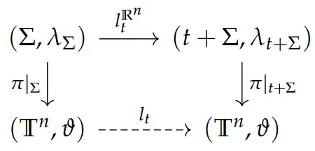

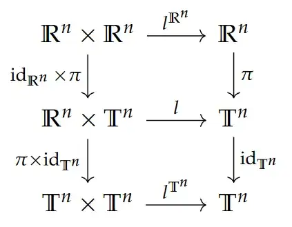

Denote by $l^{\mathbb{R}^n}_\bullet$, $l_\bullet$ and $l^{\mathbb{T}^n}_\bullet$ the left translation actions of $\mathbb{R}^n$ on itself, $\mathbb{R}^n$ on $\mathbb{T}^n$, and $\mathbb{T}^n$ on itself, respectively, so that we have:
We claim that $\vartheta$ is $l_\bullet$-invariant. This implies $\vartheta$ is also $l^{\mathbb{T}^n}_\bullet$-invariant, that is, $\vartheta$ is a left Haar measure on $\mathbb{T}^n$ (One can of course argue analogously for right translations; the fact that $\mathbb{T}^n$ is abelian or compact would guarantee that the same measure would be produced). Fix $t\in\mathbb{R}^n$. Then we have
where all filled-in arrows are isomorphisms of (standard) probability spaces and the dashed arrow is an isomorphism of (standard) measurable spaces. Invariance of $\vartheta$ is equivalent to the dashed arrow being an isomorphism of (standard) probability spaces, which is clear by the commutativity of the diagram (and functoriality of pushforwards):
\begin{align*} (l_t)_\ast(\vartheta) &=\left(\pi|_{t+\Sigma}\circ l^{\mathbb{R}^n}_t\circ (\pi|_{\Sigma})^{-1}\right)_\ast(\vartheta)\\ &=\left(\pi|_{t+\Sigma}\right)_\ast\circ \left(l^{\mathbb{R}^n}_t\right)_\ast\circ \left((\pi|_{\Sigma})^{-1}\right)_\ast(\vartheta)\\ &=\left(\pi|_{t+\Sigma}\right)_\ast\circ \left(l^{\mathbb{R}^n}_t\right)_\ast (\lambda_{\Sigma})\\ &=\left(\pi|_{t+\Sigma}\right)_\ast (\lambda_{t+\Sigma})\\ &=\vartheta. \end{align*}
