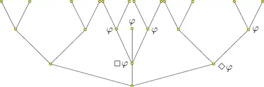

In modal logic we use the term "possible worlds" to describe some set of "vertices" with an accessibility relation defining "edges". Possible worlds are just a term for some set $W$ which we wish to identify as our frame in the context of Kripke semantics. When we define a valuation on that frame we obtain a model which has certain modal formulas being satisfied depending on the structure of the vertices and edges (in the graph theory sense).
Formally, $\mathcal{F} = \langle W,R \rangle$ is a frame, where $R \subseteq W \times W$, and $\mathcal{M} = \langle W,R, \text{Val}\rangle$ is a model where $\text{Val}: \text{Var} \times W \rightarrow \{0,1\}$ is a valuation function which sends propositions in the set $\text{Var}$ at a world $w \in W$ to a truth value (we can also define probabilities that a modal formula is satisfied at a world by considering a valuation function with values which map to the interval $[0,1]$). Depending on the structure of the accessbility relation $R$, we can have different modal axioms satisfied in the model.
For example, consider the modal axiom $B = p \rightarrow \Box \Diamond p$. If we have that $\mathcal{M}_{w} \vDash B$, $\forall w \in W$, which is read as "the model $\mathcal{M}$ makes true $B$ at all possible worlds", we say that $\mathcal{F} \vDash B$, which is that $B$ is satisfied in the frame $\mathcal{F}$. In this case, the satisfaction of $B = p \rightarrow \Box \Diamond p$ in all possible worlds ensures that the accessibility relation $R$ is symmetric, that is, $w R w' \Rightarrow w' R w, \forall w,w' \in W$. We can characterize modal frames by the satisfaction of modal axioms in this way and give an interpretation of the philosophical phrases such as "it is possible that $\varphi$" and "it is necessary that $\psi$."
In summary, $W$ is just the vertex set of a graph and modal logic studies the satisfactions of modal formulas and other properties of frames and models. I should probably mention that the following are the formal definitions of possibility and necessity.
$\mathcal{M}_{w} \vDash \Diamond \varphi \Leftrightarrow \exists (w,w') \in R \; | \; \mathcal{M}_{w'} \vDash \varphi$
$\mathcal{M}_{w} \vDash \Box \varphi \Leftrightarrow \forall (w,w') \in R \; | \; \mathcal{M}_{w'} \vDash \varphi$
We can define other modalities in a similar manner, thus generalizing to temporal logic, epistemic logic, and other interesting types of logic. Here is a pretty picture I made which gives an example of a model with an orientation (a directed graph upwards as this is representing temporal logic).
